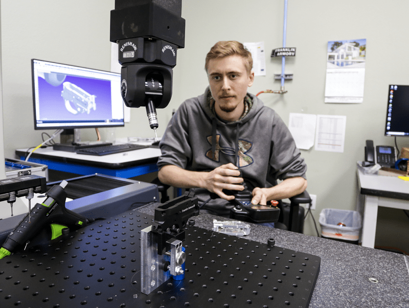

Right – The Renishaw PH-20 5 axis probe head was a must have on the CMM for its ability to access holes and slots deep inside a part.

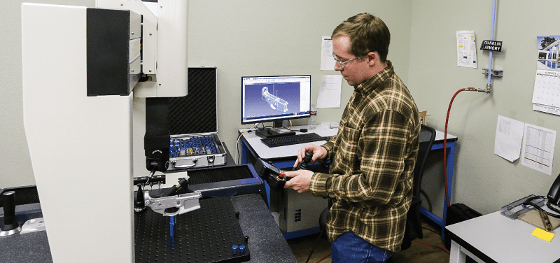

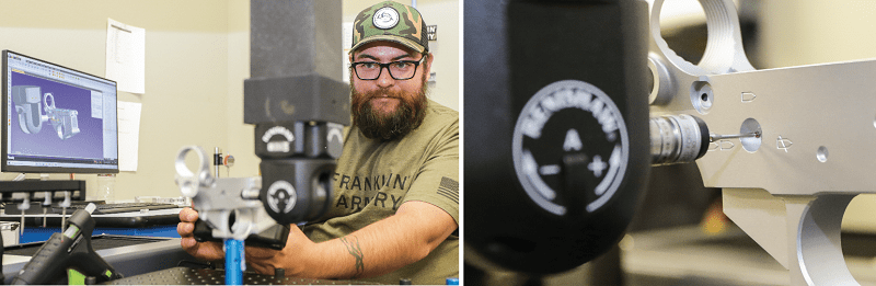

With guidance from the engineering team, Forrest is teaching himself how to get the most from the CMM. “We got the Exact CMM deep into Covid,” tells Forrest. “We primarily use it to measure the lower receivers that otherwise are very time consuming to do by hand. Most points we want to measure can be done manually with a height gauge indicator, but it takes forever. An AR style lower for example takes us over an hour to measure all the points needed by hand. We inspect it now with higher accuracy in about 5 minutes on the Exact CMM. Higher end parts and assemblies come with the expectation of better fit, better finish, and better performance. We are a company known for fit, finish, performance being above the industry standard.” “We check for fit and function,” adds Grant. “Inspecting angles, diameters, size, slot width, pin holes in relation to the face, squareness. You don’t want to pick up the weapon and have it all loose and sloppy. Our tolerances are tight where they need to be. When checking a billet lower receiver, we manually locate the part on the table and hit go. CMM-Manager auto checks all the important points. Not only is it faster, but it is also more accurate and freer of human inconsistencies. The PH20 is a fantastic touch probe system. It allows us to get deep inside a part unobstructed. On our critical holes the head goes in and touches off 25 points via a star pattern in a matter of moments.”
FAI’s R & D facility doesn’t have their own CMM yet, so they are always using the one in QC. Design engineer John holds up a top-secret prototype and explains how the CMM is a valuable tool as part of their design and prototyping processes. “This prototype assembly is in its second or third iteration,” tells John. “We can inspect it in under an hour on the CMM. Similar parts took a day doing it by hand. This item has holes within holes and at different angles. A ton of detail geometry makes it a tricky and time-consuming part to inspect by hand, but the CMM is up to the challenge.”
